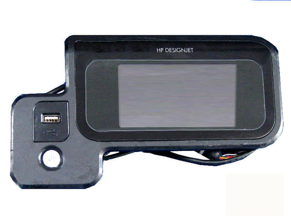

    I need to replace the front panel on my T2300PS because the image is faded and almost impossible to read. But I've read that swapping in a used panel can cause problems and generate a 59:0.3 error. Part numbers are the same but don't want to muck something up. I've already updated the firmware to the latest from the Hp website. Any experience or problems I should look out for?
    Thanks

    I went on the LPS Computers website and it looks like they sell a kit that includes a used touch screen, new hard drive and roller encoder sensor for about $200. I guess that all has to be replaced at the same time?
    • Kiran Otter
      • Dec 2013
      • 1114
      That does appear to be the case. I appreciate LPS figuring that one out.
