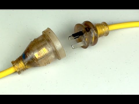

    Was working on a copier recently, spent ages stripping the fuser down, put new rollers & thermistors, put it all back together, got about 50 prints out.....then suddenly the whole machine lit up with a bright white light inside all of it...then there was a puff of smoke....was absolutely certain it was nothing I had done....then I noticed the customers all looking under their desks as there was a "burning smell"...thought I'd got away with it..luckily the workshop isn't far..so in goes a loan and theirs comes back to the workshop..I'd already seen the lead and thought surely not...removed all covers for any sign of damage..can't see or smell anything...only a scorch mark on the covers where the lead plugs in...plug in the copier...it worked perfectly..however..the customer decided to replace this copier with a new one. I've never in 30+ years seen a mains lead do this, I must admit though sometimes it has been easier to use the old lead as it wasn't easy to unplug it...not anymore..all new machines get a new lead....just in case

          The replacement cord came from the boneyard, I just nipped the female connector off of the surge suppressor and installed a new 20A female. Other than the smell, and a few sacrificial HDD's, not much damage. The part that I don't understand, is when the previous tech identified the same fried connection, could not get it disassembled ... and closed the call complete. Test OK. =P

            Tip of the day. something i really have not thought about, but really so simple. maybe many know this and i may have done this in diffrent ways. so have to remember this.

              Been doing this for quite awhile when using corded tools outside the house.

                I also have been doing this most of my life. My father showed it to me for when you had to use an extension cord with a power tool. Use it now with my ekecric lawn equipment.

                  Today i just tried this and though it is workable, i can see possible damage with the cord if pulled and thus some malfunction maybe. In an industrial workplace this would be forbbiden. But as for the use around the house, it could be usefull as the demonstrator explained
                  I think i can come up with something more feasible, so as not to stress the cords. problem, don't have a workshop at home, everything is done in my small apartment.

                    There are commercially available device that you loop the cords through to provide strain relief. When I do them, I don't pull the knot tight like the demonstrator did.

                      For better strain relief, lay the two cords side-by-side and tie a square knot, then connect the ends. You can pull all you want, and it won't damage the cords, or pull them apart. Just a little more difficult to disassemble when the time comes. And yes, thanks Dad. =^..^=
