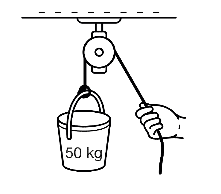

      I was hired 28 years ago based on the Bennett Mechanical Test.
      Mechanical comprehension tests are used as part of job selection process which requires an ability to work with and understand mechanical concepts.
      There were perhaps 30 of us in the room. Dan and I got 98%. The remaining gentlemen were all below 50%, so it certainly narrows it down.
