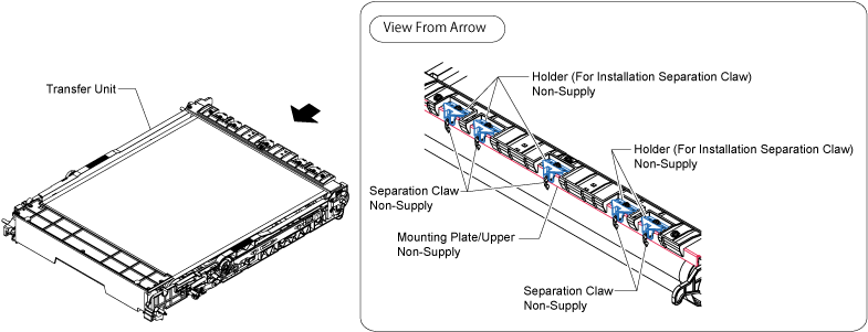

        Abnormal noise is heard that sounds like paper crinkling.
        PROBABLE CAUSES:
        1. A separator claw on the Transfer Unit may be broken by a sheet of paper when 2nd image is being transferred. (bizhub C451/C550/C650 only)
        The Mounting Plate/Upper and the Holder in the Transfer Unit has been changed to prevent this. Replace the Transfer Unit with a modified one (p/n A00J R714 44).
        Notes:
        a. The previous part number for the Transfer Unit was A00J R714 33.
        b. This issue affects Transfer Unit Lot Number A00JA500L0182313 and onward.
        2. The shaft hole and the tooth surface of the Gear (p/n A00J760301) in the Fusing Unit may wear excessively, and there is a possibility that abnormal noise or drive failure may occur.
        Replace the Gear and the Support Shaft (p/n A00J760401) at same time.
        Note: Please refer to attached Parts Bulletins #8695 and #8747 for detailed information.
