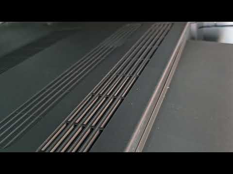

        Re: bizhub c250i annoying noises from the power supply
        The buzzing humming noise from the c220/224/258 wasn't constantly audible but this high-frequency, permanent up and down modulating tone is permanent 24/7.
        I have attached a sound sample. There's a concert in the showroom when I leave all three devices running. It's louder live than on the video.
        I can't imagine that your customers would accept this if the device was nearby in the office.
        Last spring I received a delivery containing 2-3 devices out of 20 pieces. I replaced the PSU and after that I couldn't hear any more noise. I thought these were isolated cases. But now... I opened a ticket...
          This is so brutal can't believe anyone would accept it. Chinese must be dead drunk making that batch of power supplies. Claim them all.
              Originally posted by rrrohan
              If you set Power Consumption in sleep mode to DISABLED does it help?
              No it does not help, I have already tested it because I configure all devices with this setting.
              I have now ordered 3 PSUs. I replaced 2 of them and the devices are now completely silent and one PSU is defective because the machine does not start.
