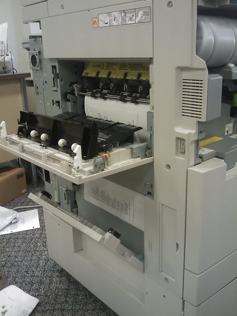

                  Still having a problem with this machine and J82 jams. Here is a picture of the jam still in the machine:
                  The bottom sheet you can see in the picture is basically hanging loose at that spot. So far the tech has done everything in this thread to no avail. At this point the tech believes its another clutch inside the main drive unit. Also, he was wondering if anyone has had problems with the stepper motor that drives the turnaround rollers? Thanks in advance!

                    i've had many many problems like this,
                    however looking at the picture it looks like the fault you r having is relating to the fuser exit solenoid.
                    if u make a copy from the glass the paper comes out of the machine face up, (like in the pic above)
                    if u make a copy from the doc feeder, u will notice the copy comes out face down
                    so looking at the picture, to me the paper should come out of the fuser exit and straight out of the exit of the machine & not down into the inverting unit
                    i suggest removing the rear cover, then the pcb and replace the solenoid that moves the paper direction guide (its the bit that has black plastic fingers on it that have to be moved before removing the fuser unit)
                    p.m me if u need any more help

                      I would also like to mention the machine will make a few duplex copies before jamming, it doesn't happen on the first one.

                        Peanut,
                        We thought we had it fixed after switching out that solenoid. We ran almost 200 duplex copies through the machine without a jam (it use to happen around 25 before). Upon duplex printing to the machine however, J82. This morning we ran some more duplex copies through the machine and it didn't appear to jam, it did however do something else that has happened before. It stops in the middle of a job and says 'Please Wait'. It has also happened when running out of paper and that was the case this morning. You install paper in the machine, shut the tray, and the machine will just say please wait and never resume copying. If you open the bottom left cover/access door there will be a sheet of paper that appears to have fallen from the turnaround rollers. Just like when getting the J82 code.

                              Can i just check, if you copy 200 pages from the platen glass, single sided does it jam?
                              why i ask this is because i want to elimate the fuser exit turnaround solenoid, its job is to direct the paper down into the inverting unit, but if u copy from the platen glass (singlesided) the paper goes out through the exit of the machine and bypass's the inverting unit
