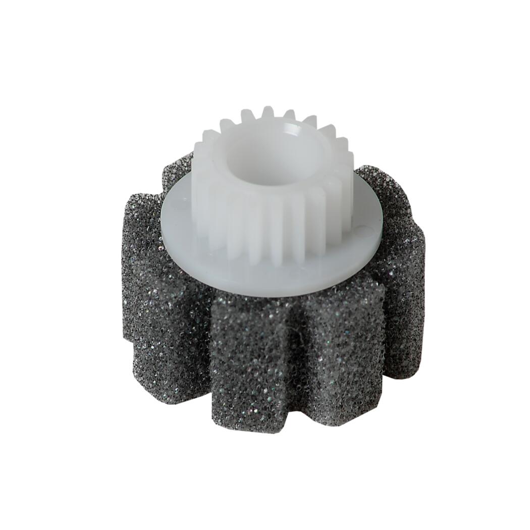

        most likely the foam exit rollers for the shift tray are worn causing the pages not to exit and stack properly causing the tray not to lower and then eventually causing the backup of pages and jamming.

              all the options suggested by colleagues here are plausible.
              if it does not stack them well, I would suggest also checking the "gathering roller", (about 30 euro) which almost always "wilts" due to deterioration of the rubber/sponge it is made of, you can try to replace the external rubber using the rubber of a pick up roller type af03-2090 or others, adding a bit of insulating tape on the plastic core to make it compatible with the thickness of the new rubber.
              *for pull out the rubber from the core of the af03-2090 see this video

                Here's some pictures. I'll investigate the rollers
                  Without those it will never work well, to begin with

                    well, it used to have foam rollers lol. i agree with everyone else, replacing them should fix it. you have downloaded the service manual for the finisher? it is different from the one for the copier itself.
