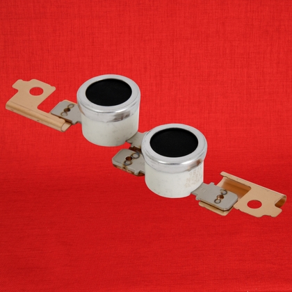

              • Richariri
                • Dec 2013
                • 163
                Re: Aficio1022 - Error Code SC541.....then Error Code SC542
                Originally posted by ritchiewheeler
                Checked & cleaned all contacts in fuser. Checked DC resistance of thermisters @ contacts where fuser plugs into copier: both about 430 kOhms. Also checked DC resistance of both drum heaters: both about 2 Ohms.
                Is fuser lamp(s) the drum heaters? Also, what is the thermostat you refer to?
                Yes.
                and this Link will show you an image of the thermostat... It is basically a thermal fuse.
                Part number for the 1022 thermostat is B0274095, although you can reset the thermostat by giving it a sharp WHACK off a table.
                If the thermostat is concave it has been tripped... convex and it is ok
                Hope this helps
                • ritchiewheeler
                  Originally posted by Richariri
                  Yes.
                  Hope this helps
                  Well, here's the story: 2 out of the 4 thermal fuses were tripped. While I was diassembling fuser, I noticed a lot of frayed & broken plastic inside (mainly around the rollers.) I put the fuser back together & crossed my fingers. STILL getting SC542 err. I've gotta funny feeling I'm going to have to replace the whole fuser in lieu of all the damage to the plastic frame inside.

                      • jtd55
                        • Dec 2013
                        • 30
                        Sounds very much like upper fuser frame has gone this machine & others are prone to it !!!
