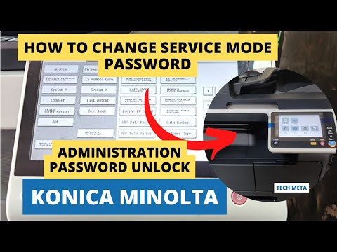

    I believe it is an incompatibility with the router, I have seen this problem with some customers. It seems that when sending a printout the printer is not woken up. What I have done is disable the function on the printer, making it always active.

          Thx, but I have 2 problems with my printer:
          1) Service Mode is password protected and I do not have it.
          2) In System settings there is no Power supply or Sleep Mode

              But I do have the admin password, I do no have the Service Mode password(the one from your clip)

                  try 9272 4 times

                      Ok, fixed only one problem
                      1) DONE + PERMIT ACTIVATED;
                      2) I still did not found those settings...
