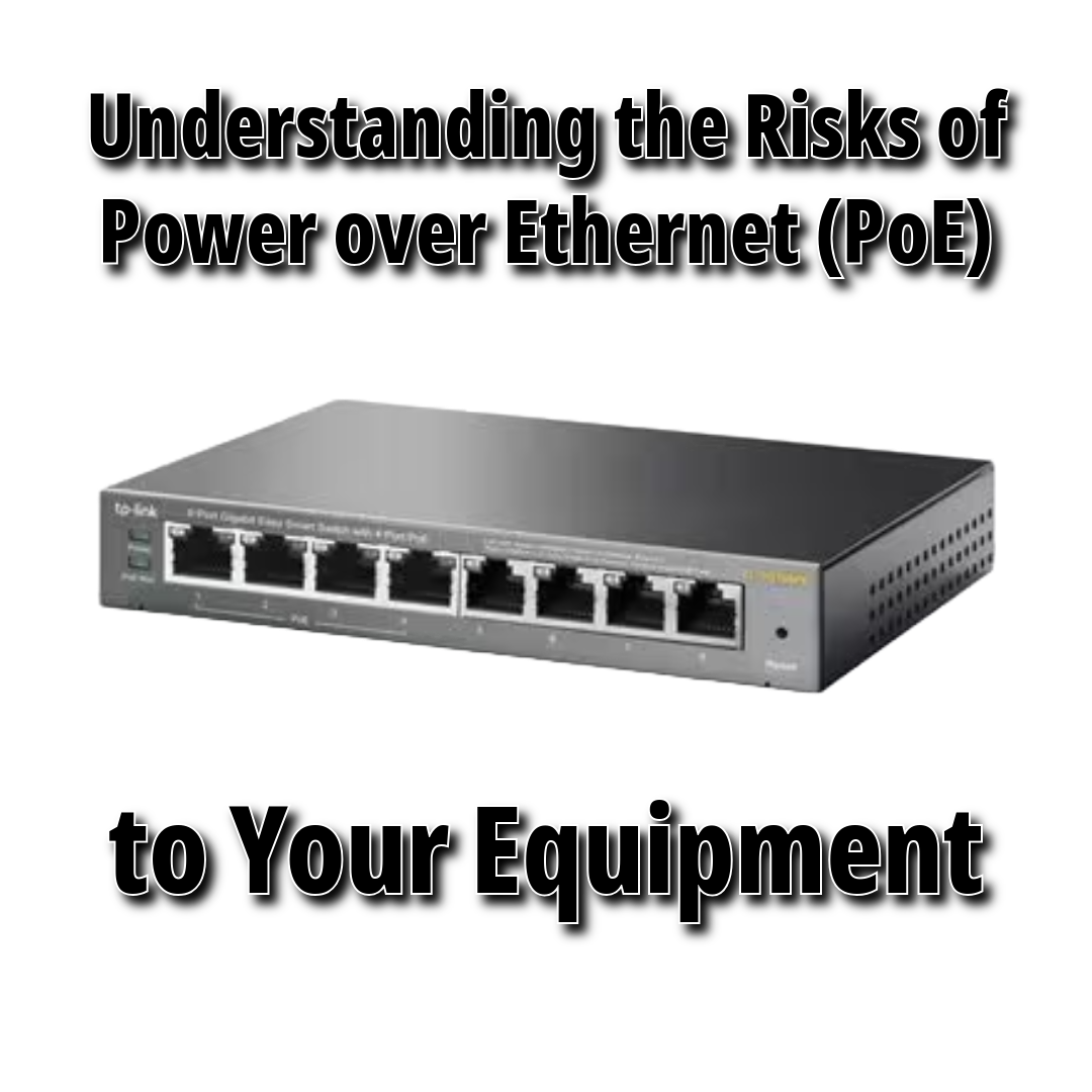

    Was looking at the brochures for the new Ricoh IMC320F and M320FW models and came across the following disclaimer at the very bottom of the last page:
    "This device does not support PoE (Power over Ethernet) and should not be connected to a PoE hub. Connecting to a PoE hub could cause damage and void warranty coverage."
    I have never seen this disclosure on any brochure ever. This disclosure has my mind thinking about the high rate of controller failures we have on Ricoh machines and has me wondering if this could be a factor as many businesses have POE switches. Just something to keep an eye out for.

      PoE devices must be connected directly to a PoE port on a hub or switch. Sometimes a 5 port work group hub or switch can be used as a filter device so long as the hub or switch is not susceptible to damage by PoE. Most but not all PoE hubs can detect if the device connected to a port is a PoE device and the exact power needed.

        Good point, I wonder if this does have anything to do with the high failure rate of the controller PCB's.

          very interesting, we had some broken controllers in a military base , they have seven MP 5055, they worked for almost 5 years, and now in a few months three machines have controller errors, two of them at the same floor.

                I found this on the net:
                Q: Can a PoE switch be used with a computer or other non-PoE devices? And can a PoE switch damage devices that do not use PoE?
                A: Yes, a PoE switch can be used with non-PoE devices such as computers. The switch automatically detects if a connected device is PoE-capable and only powers the PoE-enabled devices. Therefore, it will not damage non-PoE devices; they will simply not receive power through the switch.

                  Yes that is the standard but from what I have read not all PoE meet the standard.

                    I personally thought, more than anything that in the event of a fault it could inject voltages when it shouldn't... especially if perhaps not of good or renowned brands.
                    I here in Italy, at least from my customers, even large ones, I haven't seen one yet (luckily)
                    perhaps it is more used in the telephony sector, voip, to power telephone terminals
                    or in security enviroment for power security camera or other little device
