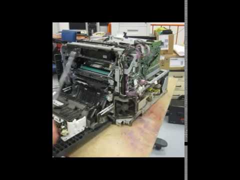

  • Kami
    Guest replied
    Re: cp3525 with 59.f0 error
    I also had 59.F0 error due to sticking solenoid. Many thanks to this forum and this video helped to fix it:
    Leave a comment:
