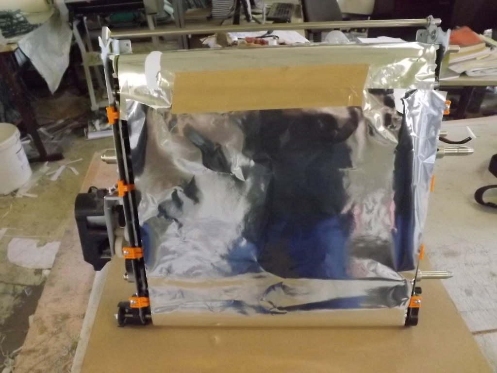

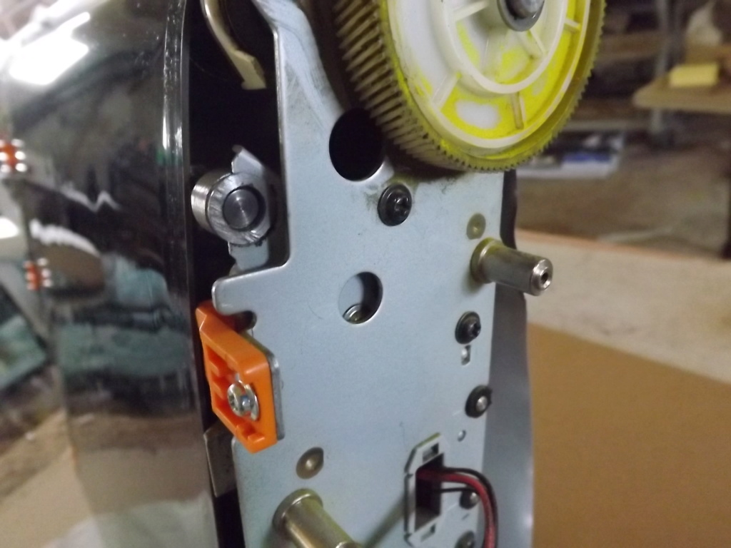

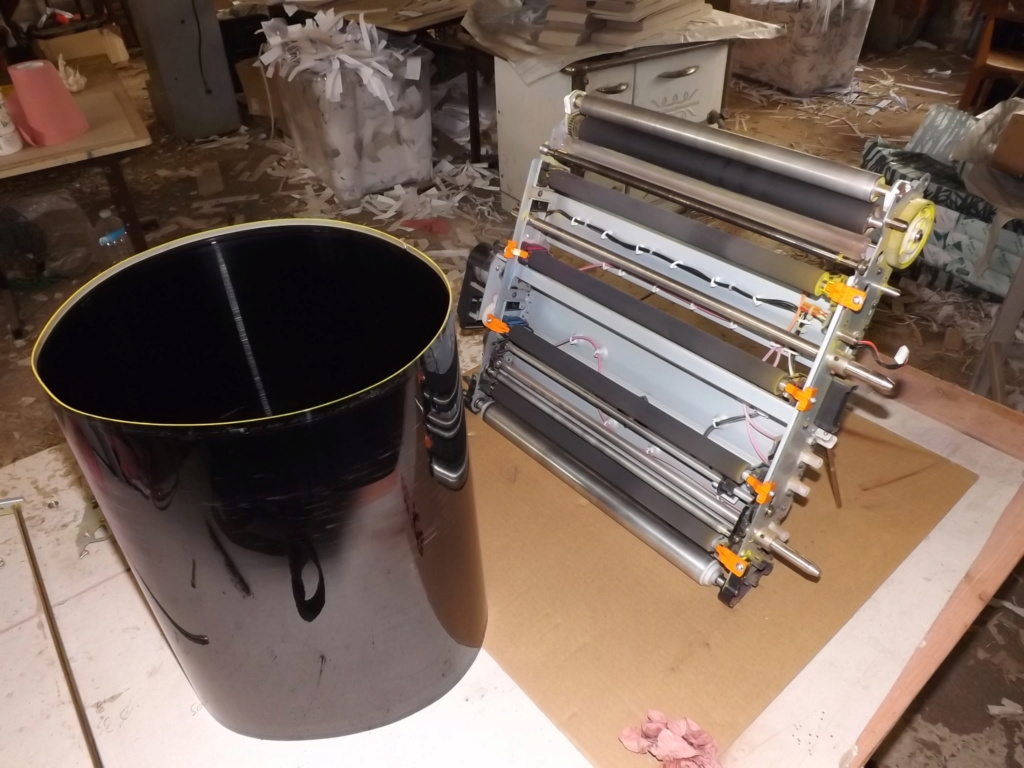

                #37
                Re: C1060 Error code- C4641
                Good morning,
                Just to say that everything is back to normal!
                Thank you to everyone for the manual and the advice.
                I replaced the entire transfer belt mechanism with a new one! With a new cleaning unit. It was not too difficult ... I took the opportunity to dismantle the old belt to neat its rolls which were very dirty because of the defective plastic scraper (damaged itself by the tensioner roller which had fallen on it for a long period).
                Do you know if we can just change the two plastic rucker blades and their support?
                To relax the belt I used two small screws to block the tensioner of the upper roller because I do not have the wedges provided for that.
                The belt is not easy to get out because it hangs everywhere.
                It is quite worn out and I think I will buy one quickly before it is no longer available.
                the little part i have made to hold the roll !
                swett dreams...

                  #38
                  um, every orange piece on that is PACKING MATERIAL and must be removed before installing.
                  i think im tripping...is this REAL LIFE?
                  IS THIS A JOKE?
                  in case this is real, you are inadvertently gonna wreck that 100000 dollar machine.
                  this hurts to watch.
                  those orange tabs PREVENT the rollers from doing their job.
                  please call a qualified tech.
                  • Yanouch29
                    • Sep 2023
                    • 31
                    #39
                    yes I know !!!
                    There are also two other small screws to remove which block the tension and which allow the belt to be tense during transport.
                    In the photo it is not the belt that I installed but the old belt that I put in the closet!
                    I put the Orange wedges back because I saw that the new one was delivered like that.
                    So if I have to move it it will be safe!
                    The new one is in the machine and works very well!
