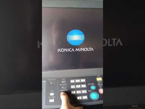

          Adjust the desired toner concentration in the developer unit and then use my product to reset the developer.
          BIZHUB C364e drum developer reset - YouTube
          M RESET C224
          This unique M RESET C224 Device enables Technicians to reset Developer Units without changing existing TCR sensors. This device has unlimited number resets and can be used as an onsite tool or in a workshop based .
          Using:
          1.
          After installing compatible developers ,in the developer image unit, it is necessary to perform a reset of the developer image unit in order for the TCR sensor to remember the concentration of the toner the value triggers the toner supply.
          2.
          In the case of errors related to the concentration of toner - developer unit (C2551, C2553, C2555, C2557, C2411, C2412, C2413, C2414, C2552, C2554, C2556, C2558, C2559, C255A, C255B, C255C, C2561, C2562, C2563, C2564. .) and after the repair it is necessary to reset the TCR sensor.(If necessary, reduce or increase the concentration of toner in the developer from the service mode)
          Compatible with:
          bizhub C220/bizhub C280/bizhub C360/d-Color MF220/d-Color MF280/d-Color MF360/ineo+ 220/ineo+ 280/ineo+ 360
          bizhub C224/bizhub C284/bizhub C364/ineo+ 224/ineo+ 284/ineo+ 364
          bizhub C224e/bizhub C284e/bizhub C364e/d-Color MF222 plus/d-Color MF282 plus/d-Color MF362 plus/ineo+ 224e/ineo+ 284e/ineo+ 364e

          With this tool you will no longer have to spend money buying chip because the tool allows you to reset as many times as you want and allows the use in other equipment infinitely resets the image Drum unit .
          The device reset drum unit allows the reset of the drum unit with a in numerous equipment of the , ie a single device can reset the drum unit more than a 72 million times and of without the need for a chip or an exchange of the chips.
          Using:
          1
          After replacing a compatible OPC drum.
          2
          Device also allows the use of black image Drum unit in place of the color image Drum unit .
          In addition to resetting the drum units the reset when permanently connected to the equipment allows the use of the drum unit K (Black) instead of the Drum unit color, ie you can buy to put in the equipment only Drum unit k (black) instead of the drum unit color thus having a huge economy since the Drum unit K (black) is much cheaper than the drum unit color.
          M RESET C224 allows to select an opc drum for reset using the switch.
          The micriswitch ON position allows resetting.
          In the position of the OF device, it can permanently remain in the device and replaces the chips of all drum units.
          (in the bizhub C220 series .. it can replace black and one color)
          M RESET can also reset toner status chips for C554e, C308...
          M RESET C224 has a light indication of a successful reset.
